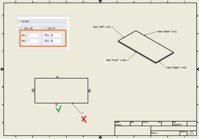

I have custom parameters created in my part, Ak1 Ak2 Rk1 Rk2
I would like to place iLogic in the selected view in the drawing, the leader's note according to these parameters. And put them on the edge.
Previously, I did not dare to make such a request on the forum, but after seeing what miracles @JhoelForshav  does, I will ask

Forgot to complicate the task. If there is nothing in the custom options, the leader does not appear 😉
And for those users who do not know how a callout is made with pens, I attach a video

It's a difficult task. Maybe this code will at least give you someideas.
Since the view is a simple square i can use its properties top and left to find curve segments on its edges. Then I can create geometry intent from these segments parents (drawing curves).
It seems however that text justification is ignored when it comes to leader notes, and since the notes position is the same wether the text is over/under the line as long as it's attached to the line I can't find a way to move it to the outside...
This code:

will give a result like this:
Message 4 of 19
JhoelForshav
Are the squares around your text something that comes with your note style?
(I only have Inventor 2020 so I can't open your drawing to see how you've done it)
I managed to get the annotations in the correct positions now so maybe this is it?

Yes, I told you that you are a genius in solving the most difficult problems 👍. Since I am a specialist in creating unsolvable problems  😉
Again, I'm doing something wrong, not one of the rules does not work for me 🙁

I have parameters in the wrong place Here is a video of where they are
@JhoelForshav   Is it possible in iLogic to use these parameters?
Message 9 of 19
JhoelForshav
Ahaa, those are properties, not parameters 🙂
Try this:

Thank you so much. Everything works fine. I owe you wine again. 😊

robertast
Hi @JhoelForshav
Maybe you can still correct the code so that it overlaps by name at the edges of the inscription? Nobody can do it without you. I've already tried looking for help.
Message 14 of 19
JhoelForshav
@robertast
Sorry, but I don't understand what you're asking for here🤔
Message 15 of 19
robertast
Each property should fit in accordance with the face name.
Ak1 = "Front" ; Ak2 = "Back" ; Pk1 = "Left" ; Pk2 = "Right"
Message 16 of 19

Many thanks. I told you that it won't work without you. I turned to other specialists for help, but they could not.
Now the rule works almost perfectly, except that in one projection it overlays the inscription inside the part. But this is not critical - I will correct it with my hands.
Message 18 of 19
JhoelForshav
