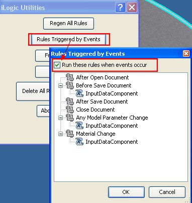

How to make Automatic Update propeties for Flat Pattern Extens. I have write code and setting rules trigerred by event (Before save, Any model Parameter Change) but if some parameter change properties isn't automatic update. So could some one tell me how to solve this problem.

xiaoyan.qi
Unfortunately, i still can't reproduce your problem , see my attached Vedio for details
could you check whether the "Run these rules when events occur" option is checked in your machine?
if it's still not the problem, you can try to create a Rule to run the current rule, see my attached ipt file
Hope it can be work this time

abilabib
Hi Xiaoyan,
Thanks for your reply. It's solve now n case close Smiley Happy.
