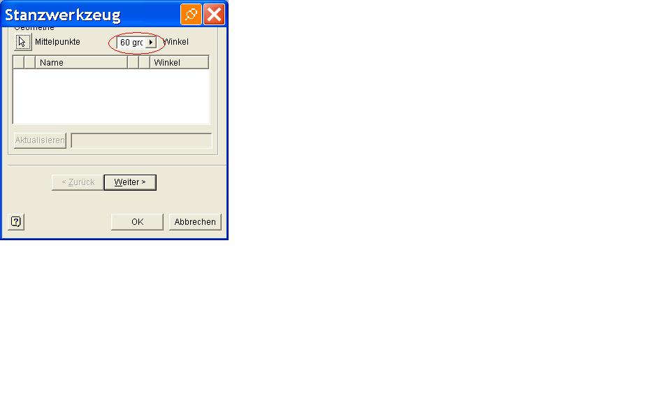

i found this thread by Google...
how can i find out the insert angle of an iFeature ?
regards
Andreas
