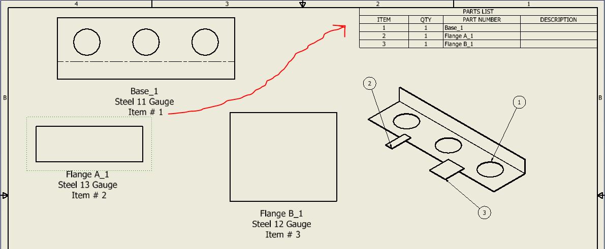

Hi, I am a novice at using Ilogic. I would like to create a code that will do the following:
     1. Place a custom iproperty from my ipt. template into the view label. This iproperty is called "SheetMetalName".           2. I would also like it to write the name of the file below that.
     3. Lastly,  I would like it to say ITEM # X with X being the item number from the IDW's parts list.
               I have attached an image below of an IDW where I manually created the view labels the way I would like them to appear. If anyone could write a code that will do this or give me a clue as to how I can achieve these functions, that would be great. Initially I attempted to do this using the style editor but was unable to as I could not place a custom iProperty in the styles editor and I am unsure of how to access variables from the Parts list. I would like for this label to appear and populate as soon as I place the view in the drawing. Thanks in advance for any help.

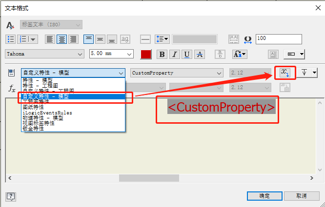

yuzeaa
First you need manually create view label and insert your customproperty
Then , you need check your label formattedtext .

smanionDV2GJ
Hi. Thank you for putting this together. I really appreciate your time and knowledge on the subject. Unfortunately, this code does not quite suit my needs. This is likely due to the way I asked the question. Let me try to present what I need more clearly. Here are the goals I would like the code to achieve.
     I would like for:
1. The view label to automatically pop up when I add a base view.
2. The first line of the view label to show as the name of the part.
3. The second line of the view label to show as the name of the current sheet metal rule. (Initially this was a custom iproperty from the ipt. file but this does not work for iam files that are split into ipt's, so any way to achieve this would be great.)
4. The third line of the view label to show the word "ITEM #" along with the item number value pulled from the parts list. If there is no parts list, I would like this line to not show up at all.
     Thanks again for your time and efforts. Any help with this would be greatly appreciated.
