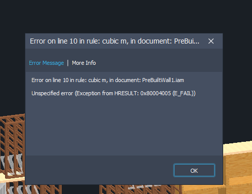

Anthony5375F
Thank you for getting back to me.
I am getting an error code pop up (attached). My current construction is as follows:
Parts within an assembly that contain all my parameters. Then my assembly has the total qty of material reading the parts parameters. I then have these parts within a main assembly. Is there a way for my main assembly to read the placed in assembly parameters only? I mean the way you have shown would do the same thing thinking about it.
I am new to i logic and have only really scratched the surface. I am currently pre build large areas that are fully adjustable with it updated the total qtys i am after.
I hope this makes sense thank you again
dalton98
I would need more info on the rule, the error is vague. And if you just want the top level components of the main assembly delete '.AllLeafOccurrences' and replace 'PartDocument' with 'Document' in the code I posted.
