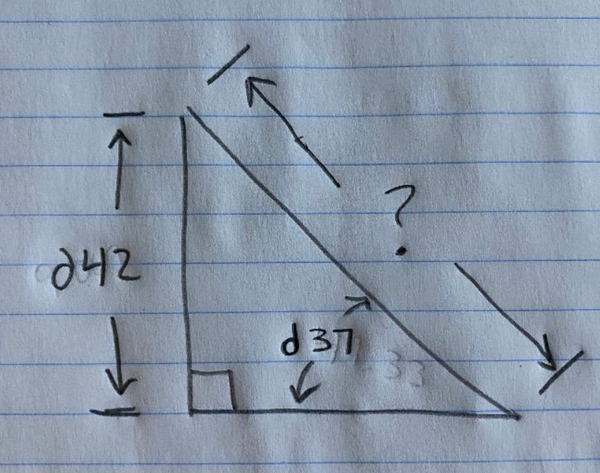

chris
I need to get the length for the long edge, I'd like to know how to write this in iLogic and in the parameter window

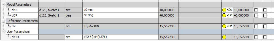

Andrii_Humeniuk
Hi @chris . Function in parameters:
Rule in iLogic:
MessageBox.Show(d42/(Sin(d37*PI/180)))

chris
@Andrii_Humeniuk Awesome, Thank you!!!
