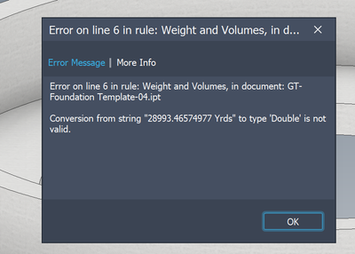

chris
I'm trying to add the string "Yrds" to the end of this iLogic code, but it's giving me an error, I thought concatenating it would be fine, but obviously it is not?
WIP = Round(iProperties.Mass, 0)
iLogicVb.UpdateWhenDone = True
InventorVb.DocumentUpdate()
VIG = Round(iProperties.Volume, 0)*0.00495113 & " Yrds"
This code is taking a user defined parameter in volume gallons and converting it to volume yards, but I need "Yrds" to show up at the end of it.

Message 2 of 14
Andrii_Humeniuk
Hi @chris . To place text in a variable, you need to declare this variable as a String. In this case, you need to declare VIG as a String type. This will allow you to place any data in the variable.
Dim VIG As String = Round(iProperties.Volume, 0) * 0.00495113 & " Yrds"

chris
@Andrii_Humeniuk Thanks, even when I add your code, "Yrds" still doesn't show up in the final result. I even added a new user defined parameter as "text" and tried it, and it also still doesn't show up? weird...?
Message 4 of 14
Zach.Stauffer
Andrii's code works for me. Are you resetting your parameter somewhere else, or is the document update setting it to something different?

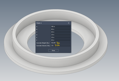

chris
@Curtis_Waguespack  It's just a part (attached 2025 version), what I am trying to get is the yellow text at the end of the results for weight and yards (see image).... note: I changed VIG to be VIY
Message 9 of 14
Curtis_Waguespack
Ahh, I see. I think you will need to make the parameter a Text parameter
delete it, recreate it as a Text parameter, and then replace it in the form, then it should work.
Message 10 of 14
chris
@Curtis_Waguespack The only issue I see with that is in the example you sent back, the total yardage is 17795, but the correct amount should be 131, any idea what is causing the math to be different?
Message 11 of 14
Curtis_Waguespack
wait, you want it to calculate correctly too! 😁
yeah, so when we changed from a numeric gallons parameter, to a text parameter, we removed the internal conversion or whatever was happening with that parameter, so the code conversion factor needs to change to go from cubic inches ( the document unit) to cubic yards. I think this is correct now.
