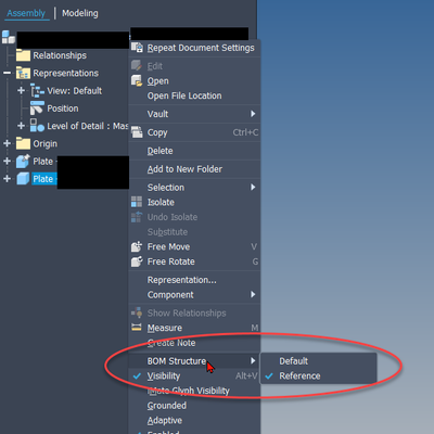

I am struggling how to use commandmanager on all non referenced parts (BOM structure) of an assembly.
I want to open all parts of an assembly and do an "operation" with commandmanager, but only on those parts that are not set to reference (in the assembly BOM structure)  and also their iproperty "part number" should start with "AAA".
The "operation" with commandmanager is to activate a third party add-inn on the specific part, but that just as an information why I want to open the parts.
My problem is checking the "If" condition about the BOM structure. (in line 11). I am doing it wrong. I am obviously checking the  "BOM structure" of the part itself and not which "BOM structure" (default, not set to reference) the part has in the assembly.
Can anybody give me an advice how to improve my code?

I will try to explain "how a part can have two different BOM structures".
A part (.ipt) can have a certain "Bom Structure" set, which is then the parts default BOM structure.
In the assembly level that part can be either in it's default BOM structure or set to "reference":
(The reason is that a part can be in different assemblies and in one assembly it can be set to reference but in another assembly it has its default BOM structure (for example "normal")

I finally understood you. I had no idea that it was possible to do that. Here is the code that should help you, pay attention to line 17.

First the code worked on the "set to reference" parts, but I want it to work on the "default BOM structure" parts, so I added a "not" in  line  17 :
If not oOcc.BOMStructure <> BOMStructureEnum.kReferenceBOMStructure Then Continue For
But that is just tiny adjustment.
