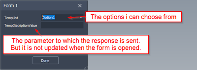

hi,
I am trying to make something, but I am not succeeding.
In a rule I create temporary paramter. In this case it contains 2 options. Then I open a form. The idea is that if you switch options, you get to see different info. In a message box I get the desired result, only the form does not update.
Is there any way to update the form so that it shows the updated parameter?

I want to use this to display a list of materials to choose from. Depending on the material chosen, I then want to display the properties. Therefore, I use temporary parameters

WCrihfield
Hi @yvette.van.den.bosch.  You may have to use separate iLogic rules for something like this.  When you launch an iLogic Form from an iLogic rule, the iLogic rule will remain 'paused' while that iLogic Form remains open, then will continue once that iLogic Form closes.  So, you will not be able to do anything to that iLogic Form from that same iLogic rule while that form remains open.  That rule that launches the Form will be notified though when that iLogic Form closes, as you may have already discovered.  Plus, if using an event handler code by iLogic rules, it is best to use an 'external' rule just for that event handler part, and have the other stuff in a different iLogic rule.

Thank you for your responds.
With the help of the event handler the code goes into the Sub "oModelEvent_ParameterChange". If you then switch between the options, a massage box with the desired result will appear. In the form I display the parameter to which the answer is written. Only the form does not update the parameter. So it looks like some kind of 'update form' is missing.

Lots of stuff going on there, but definitely need a document update after setting any parameter values.  Plus, within the event handler, it seems like you want that secondary value to be assigned as the value of your 'TempDiscriptionValue' parameter.  Well, when using a blue, unquoted parameter name in your rule, the parameter value changes set to those also need a special document update to see the results.  Use "RuleParametersOutput" (without the quotes) after any parameter value changes using those blue, unquoted parameter names.  When using Parameter() to change values, use Parameter.UpdateAfterChange = True at beginning of rule.  When using MultiValue to change param values, use MultiValue.UpdateAfterChange  = True at the beginning of the rule.  When changing param values using Inventor API, just do a regular Document.Update2(True) or 'InventorVb.DocumentUpdate'.  Heading out now for the day.  I'll check back tomorrow, if I remember.

I tried both options. But the solution was indeed to take the code apart. I did this and now it works perfectly!
