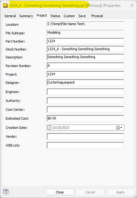

Results for filename = 1234_A - Something Some-thing Something.ipt , with extra dash
Results for filename = 1234_A - Something Something Something.ipt , with Revision
Results for filename = 1234 - Something Something Something.ipt , without revision

Many thanks @Curtis_Waguespack - this worked so nicely.
Very clean - and exactly what was needed 🤗
