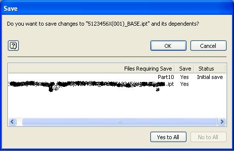

I wonder how I can save a new part with a name automatic?
When I saveas after I create a new file, a dialog as me to Save dependent document.
How can I turn this off?

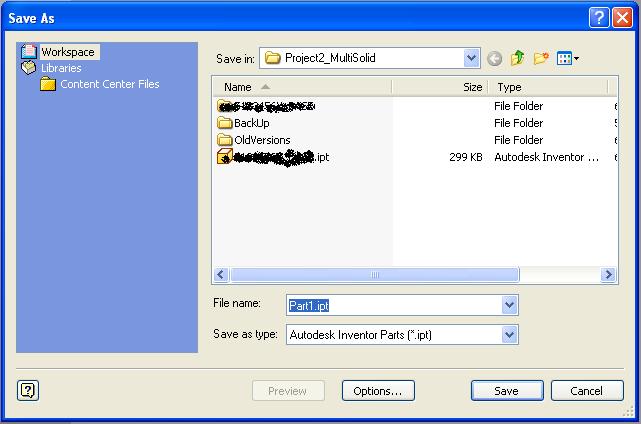

If I use Save2 first, because the document doesn't have name yet, a SaveAs dialog will open.
I want that the program does everything by itself without any touch, any OK clicking from user.
Is it possible?

Give this a go.
app.SilentOperation = true;
//Make, save and close document here
app.SilentOperation = false;
Amazing.....that is what I need!
Thank you so much!
