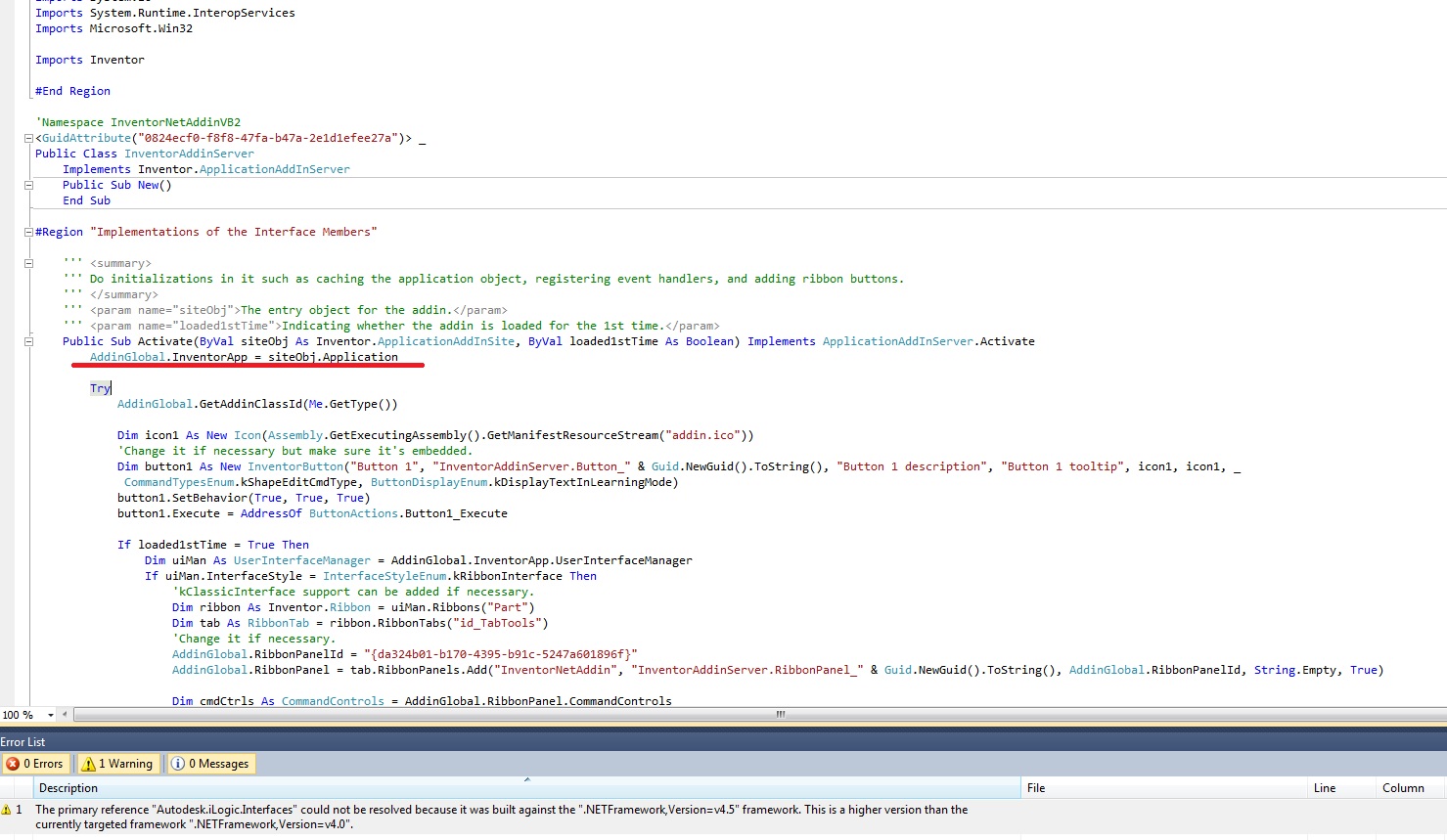

fakeru
So I'm pasting the code above in the space indicated in the screenshot, replacing the message Hello! I guess that is completely wrong.

Message 9 of 17
EelcoWiggers
Hi Alexandru,
The Error is because the oInvApplication is not assigned at the start of your addin.
You didn't place the Inventor Application object/variable oInvApplication in the InventorAddinServer Class as I said in my previous post, you still have the Inventor Application object/variable InventorApp placed there. That is no problem, leave it there and delete the Inventor Application object/variable oInvApplication I told you to place in the AddinGlobal Class. You don't need two of them.
The next thing you need to do is replace the Inventor Application object/variable oInvApplication in the code I provided you with the Inventor Application object/variable InventorApp and your code will work.
