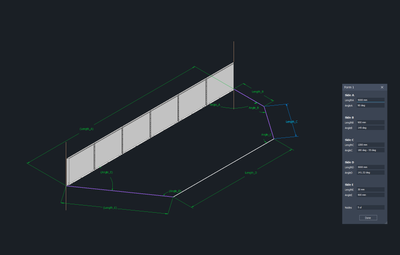

Hello every one, I whant to make the dimension below (Lato L) driven using iLogic

hi, my sketch (named Perimeter) its in a assembly, and i would like to make the dimension "Length_A" driven

OK.  I was able to open your model and see the sketch & dimensions.  Although the referenced components didn't load correctly, I was able to quickly create a simple iLogic rule that will do the task.
Dim oADoc As AssemblyDocument = ThisDoc.Document
oSketch = oADoc.ComponentDefinition.Sketches.Item("Perimeter")
For Each oDim As DimensionConstraint In oSketch.DimensionConstraints
	If oDim.Parameter.Name = "Length_A" Then
		If Not oDim.Driven Then
			oDim.Driven = True
		End If
	End If
Next
The rule immediately changed the status of the dimension from 'driving' to 'driven', without the sketch even needing to be in 'edit mode'.  Since we know the name of the sketch, and that the sketch was created within the context of the main assembly, I just got the sketch by its name.  Then to find the right dimensional constraint within the sketch, I simply looped through all the dimensional constraints within the sketch, checking the name of the Parameter it is tied to for "Length_A".  When found, simply change its Driven property's value to True.

i created a rule with the code that you gave me but it doesn't convert Length_A into a driven dimension. When i run it and the dimension Length_A is not driven it does nothing, but when Length_A is driven the rule conferts it into a non driven rule.
I attached the file that i used, the ruler's name is Length_A

Hi @JonnyPot.  I opened new top level assembly in your latest zip file.  At first, sketch dimension using the "Length_A" parameter did not have the "(" and ")" symbols around its name.  That means it is currently 'driving' (in control of) the geometry.  When I enter into edit mode of the sketch, then right click on that dimension, I have the option in my radial menu to turn it into a 'driven' (not in control / reference only) dimension.
When I choose that option, the name of the dimension changes, and now shows the "(" and ")" around its name, indicating that it is now a 'driven' dimension.
Then if I right click on that dimension again, that option shows up in my radial menu again, but this time it already has a check mark in it, meaning that the dimension is already 'driven', so choosing this option again will toggle that setting off, making the dimension 'driven' again.
When the dimension looks like this:
before I run the rule, then I run the rule you have there named "Length_A", it changes that dimension to looking like this:
When it has those "(" and ")" around its name, the dimension is then a 'driven' dimension.  That's why when you get the DimensionConstraint object in the API, it has that Property called "Driven", and its value is a Boolean (True/False).  When the value of that property is set to True, that means the dimension is driven.  When its value is False, it is not driven.  Well, the code was designed to make sure the value of that Driven property of that dimension gets set to True, and it appears to be doing its job OK to me.
If you would rather have the code simply 'toggle' its value, instead of always set it to True, that can easily be done too, by replacing this:
	oDim.Driven = True
End If
with this:
oDim.Driven = Not oDim.Driven
Then, if the dimension is currently driving, running the rule will toggle it to driven, and if the dimension is currently driven, running the rule will toggle it to driving.
