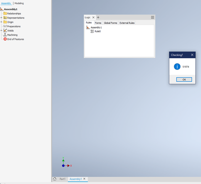

Thanks for the previous solution. I still have a problem: the first run Inventor, the rule run correctly with this rule (Assembly1 = picture 001),
but when I create a new part the rule can't run and give an error (part1 = picture 002).
Can you help me? Thanks for your time to support!

I cannot get it to fail on my machine, but if you have the rule locally in the document maybe try ThisDoc.Document instead?
Also I changed it to return the enum name instead of number if you're more intereseted in the name 🙂
'Dim nDOC As Document = ThisApplication.ActiveDocument
Dim nDOC As Document = ThisDoc.Document
MessageBox.Show([Enum].GetName(GetType(Inventor.BOMStructureEnum), nDOC.ComponentDefinition.BOMStructure), "Checking?", MessageBoxButtons.OK, MessageBoxIcon.Information)

My problem with Inventor version 2018 and previous versions. with 2020 it runs correct! Both yours rules code are very good.
Any idea for me? I'm using Inventor 2018.3.8 Updated. Thanks,
The Detail Error:
System.Runtime.InteropServices.COMException (0x80020003): Member not found. (Exception from HRESULT: 0x80020003 (DISP_E_MEMBERNOTFOUND))

It's difficult for me to figure out the problem as I don't have inventor 2018. But I'm thinking it might have something to do with the document not being saved, if it only fails on new documents?
Maybe try to save document before running the code? 🙂
Message 10 of 10
ngdnam88
Thanks @JhoelForshav
It's happened with saved and not saved documents. I'll try to find another way to check the document. Thanks one more time!
