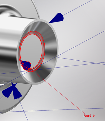

Hello everyone. I'm programming dimensions in the idw file using iLogic. In my 3D part, I have the intent "Face9_0". In my .idw drawing, this radius could be dimensioned on either the right or left side, as you can see in the picture. My code automatically creates the dimension on the side where the dimension is in red, but I would like to create it on the side where the dimension is green. How can I control this?
Below I have a small piece of the code (incomplete).
I needed to understand how to do this, as in many other views I have a similar issue, where the side option is relevant due to other dimensions and space availability.
Thank you in advance to anyone who can or knows how to help.
