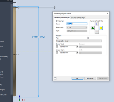

Hi everyone,
I'm trying to find a way in which add in a automatic way the linear limits according to a standard rule like ISO2768-mk, because we are using a new machine in which we upload the file in .step.
What I am doing now is adding the tolerances manually in the sketch, and I would like to know if there is a quickest way to do that.
Hope you can help me.
Thanks.

Thanks for your reply, but it is not what I'm looking for.
Here there is a picture in which you can see that I'd added the specific tolerances, those that are out of the general rule ISO 2768 for the standards tolerances.
I want to add to every dimension (that hasn't a specific tolerance) the general linear tolerances, according to the rule, but in an automatic way.
Maybe am I looking for a setting in which I can add a general rule for the tolerances??
Thanks!

I have made an attempt at a solution for you.  I'm not sure if it is exactly what you wanted, and it may need more 'tweaking', but there's quite a bit of work done for you in there, so it should be a pretty good start, if you need to further customize it.
I created a custom 'Enum' to control the expected input variable for what tolerance class you want to use.
I created a separate Sub routine do define all the tolerance and tolerance class settings in, to leave the main Sub a but cleaner, and you could even move more of the main Sub's code down into it if you wanted.
It assumes you are targeting the 'first' planar sketch in the part document, but you can change that however you want, if you need to specify a different sketch to target.
It is only targeting two variations of dimension constraints within the sketch, because there are many types, and not all are linear, just to avoid potential error for now, but you can expand which ones you want it to work with if you need to.
It is set to only work with dimensions that are 'driving' (not 'driven').
And it only tries to set a tolerance if the parameter being represented by that dimension is currently set to 'Default', so it won't bother ones that have a different type of tolerance already set.
Here's the code.
(Make sure you read through it before attempting to run it, and probably run it on a 'test' part first, just to be safe.)

Many, many, many thanks, that's what I was looking for.
Thanks again for your time 🙂
