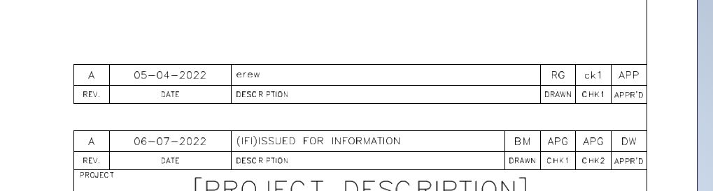

Hi Guys,
I am trying to replace the empty revision number in my table using a code. Basically I want it to detect if there is any text and then if nothing is found, set it equal to 1, whereas if it already 1 or greater it will increase and so on everytime a row in the revision table is added.
The revision table looks like this:
This is a snippet of the code for the section I am trying to code:
	 Dim oCell1 As RevisionTableCell = oRow.Item(1)
	If iProperties.Value("Project", "Revision Number") = "" Then
		iProperties.Value("Project", "Revision Number") = 1
		oCell1.Text = iProperties.Value("Project", "Revision Number")
	ElseIf iProperties.Value("Project", "Revision Number") > 1 Then
		iProperties.Value("Project", "Revision Number") = Fruitloop
		Fruitloop = Fruitloop + 1

Hey,
Thanks for your reply... I did try that but the revision column was always left blank.
This is the code:

A.Acheson
I have modified the  rule you supplied above as the move sub routine had being replaced by another sub routine. Regarding Cell 1, the revision box will populate if the revision table  is new to the sheet. We are simply automating the manual process for using autoindexing shown in the image.
and these are the lines that carry out this
oRTB = oRTBs.Add2(oTablePt,False, True, False, "0" )
and here is the explanation of this call and what variable to modify
'add a new revision table instructions
		'RevisionTables.Add2( PlacementPoint As Point2d, [IsSheetScope] As Boolean,
		'[AutoIndex] As Boolean, [AlphaIndex] As Boolean, [StartValue] As String,
		'[RevisionTableStyle] As Variant, [Layer] As Variant ) As RevisionTable
 and this line takes the revision table REV number and places in the iproperty revision number
oRTB.UpdatePropertyToRevisionNumber = True
So this leads to the next question are you modifying a lot of revision tables that are existing? If there is only a handful you could just delete and recreate with the auto indexing switched on. This way when you manually have to modify the revision box and add a row everything works the same.
Working Rule:

rfgeefshuysen
Hi guys, i've implemented this rev table rule too! added a couple of columns and changed it here and there so it fits our purposes. it works amazingly. just one question left: we work with alphabetical revisions. how can i change that, since we have numerical revisions with this code.
also can i apply this to different rev table styles?
one rev table has 1 draftsman and 3 checkers (for developed in house components). the other rev table has 1 draftsman and 2 checkers( for external projects).  so im actually looking for another pop up right at the start that asks for: "project" or "component". depending on that i have to fill in 2 or 3 checkers/approvers.
Message 6 of 11

Message 8 of 11
rfgeefshuysen
Awesome the alphabetical revision works fine now!
for the revision styles.. I'm obviously not that experienced in coding.
if I understood correctly, edit the style like the following
oRevStyle = oDrawDoc.StylesManager.RevisionTableStyles.Item("Revision Table (ISO)")'Revision Table (ISO)'You can enter in a revision style by name sample "Rev Table 1"
 and change the revision table RevisionTableStyles.Item("Revision Table (ISO)") to, in our case,  "PROJECTS"
then add in some code "case/if" ? and then add in this rule again?
...RevisionTableStyles.Item("Revision Table (ISO)") to, in our case,  "COMPONENTS" (see picture for styles)
then i have to copy the whole code underneath and past it somewhere haha. see.. I'm lost haha
last things..
determining the position of the rev table. how can i influence that?
see picture, it's placed at the drawing border instead of above the stamp.
and use the current date or select a revision date? is that also possible?
Again, I'm very thankful for your help, this coding is a whole new side of inventor that I really like
Message 9 of 11
A.Acheson
  1. Up near the top you can place a boolean message box and set the style object. See below if statement.
  2. You will need to create a new subroutine for the extra revision table modification denoted by RevisionTableContents(oRow) call the new one RevisionTableContents2(oRow). Which is just a copy of the original and change around the cell referencing as you need. Just do one step at a time and test to ensure it still functions.
  3. Next use a similar if statement as the style to switch the sub routines for modifying the table. This should minimize the extra code and allow the changes you need.
If TemplateName="PROJECTS" Then
	oRevStyle = oDrawDoc.StylesManager.RevisionTableStyles.Item("Rev1")
ElseIf TemplateName="COMPONENTS" Then
oRevStyle = oDrawDoc.StylesManager.RevisionTableStyles.Item("Rev2")
End If
  I looked at the move and if you run the rule in sequence it should move the revision block correctly as it is simply measuring the length of the revision block and adjusting it in from the border and up from the titleblock.
Regards
Alan
