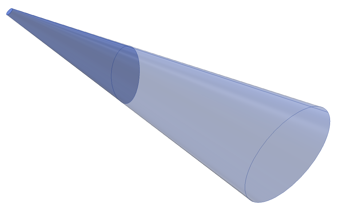

I have an elliptical cone rotated in two planes that is cut with a cylinder in an assembly document. What I would like to do is programmatically (iLogic, VBA, or VB.net) get the surface area of the face after the cut. I was able to get surface areas from part documents using the code (iLogic) below, but I am unable to get it working in an assembly document. Can you help?

  • Even though the same part is used in the assembly, is it being modified in the assembly document. (Reference "Extrusion 1" in the assembly document.) Please also see the screenshot attached; it shows the original cone overlayed on the one modified at assembly.

Your spherical cut is subtracting over 60% (9cm length / 24cm length) of the cones length, that definitely shrinks the assembly surface area.
