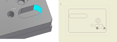

I'm selecting part's face in assembly environment through vba, after selecting face. I want to get the centre of the slot
If fac.Edges.count = 2 Then 'consider as hole
Set holeCenter2 = assyDoc.ComponentDefinition.WorkPoints.AddFixed(fac.Edges.item(1).Geometry.Center, True)
ElseIf fac.Edges.count = 4 Then 'consider as slot hole
Dim pt1 As Point
Set pt1 = fac.Edges.item(1).Geometry.Center
Set holeCenter2 = assyDoc.ComponentDefinition.WorkPoints.AddFixed(pt1, True)   (here point A , i'm getting, but i want to get Point B as shown in image )
End If

tim11_manhhieu
B point is midpoint of AA', i think you need to pick two faces, face for point A and face for point A'.

gopinathmY575P
in ideal case, I will pick always one face only (for both hole features and slot hole features). may be fac.createdbyfeature will help... from that i can able to access that B point i'm thinking of that.

tim11_manhhieu
Because the slot hole has an additional variable of hole length,
I think it is impossible to distinguish between a regular hole and a slot hole from just one face.
In fact, if you want to draw a slot hole, you also need to have the length of both ends of the hole.

gopinathmY575P
edge's count value is 2 for normal clearance hole whereas 4 for slotted hole

tim11_manhhieu
you was right, but not enough data to find the desired point B position.
Because the position of point B will depend on the position of the other end of the slot hole.
I think the sequence should be like this,
1) pick any 1 face
2) if that face is a regular hole face then do something
if that face is a slot hole face then pick the face of the other end.

WCrihfield
If the hole or slot was created as a single feature, and not just one of many in a single feature, then there is another route that you could consider for finding the center point of the slot.  I have seen (and likely participated in) multiple other forum discussions about similar goals in the past, and after searching within my custom iLogic snippets, I found an iLogic rule example in there which is related to this.  I do not recall what other forum discussion this may be from, or if I authored some or all of it or not, but I will post the code here anyways, just as added reference and ideas.  The code asks the user to select the 'feature' right up front (not just an Edge or Face), then starts digging into its geometry to identify it as a slot.  Once that is determined, it uses the 'profile' edges to get their 'centroid', which would be at the center of the slot.  Then it creates a WorkPoint at its top, and bottom center points.  Then it creates a WorkAxis which passes through those WorkPoints.  Then it extrudes a cylindrical surface around that center axis.  I don't recall why all the work features and surface were used, but it may have been an 'alignment' project, where they will later be aligned with holes in another part in an assembly.
