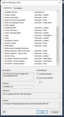

Hi all, Im getting error of MSB 3073 Shown below,
and when I launch Inventor, I cant see that addin in my addin list
Im using visual studio 2022 17.11.5 and inventor of 2025 version.
