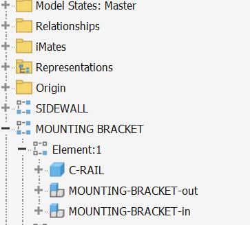

I thought it is simple but i just dont get it going.
I have a known component/Display name in an assembly. Now i want to get the filename of this component based on the Display name in the Assembly to open it as a separate document, save it and close it. In the picture below you see the assembly tree... I want to open "C-RAIL" and save it, close it... then open "MOUNTING-BRACKET-out" and save it, close it... then open "MOUNTING_BRACKET-in" and save it...
This assembly will always get copied so i cannot use a static filename, i know how to open the document when i have a fixed filepath but i need to get the filepath and name through the assembly

Hi @Jonathanspies. Take a look at this example:
Dim oADoc As AssemblyDocument = ThisDoc.Document
Dim oADef As AssemblyComponentDefinition = oADoc.ComponentDefinition
Dim oOccs As ComponentOccurrences = oADef.Occurrences
Dim oOcc As ComponentOccurrence = oOccs.ItemByName("C-RAIL")
Dim oOccDoc As Document
oOccDoc = oOcc.Definition.Document
'or
'oOccDoc = oOcc.ReferencedDocumentDescriptor.ReferencedDocument
Dim oFFN As String = oOccDoc.FullFileName
Dim oFDN As String = oOccDoc.FullDocumentName
Dim oDName As String = oOccDoc.DisplayName

is this what you are looking for?
Dim yourOccurenceName = InputBox("Give the name", "Get name", "")
Dim doc As AssemblyDocument = ThisDoc.Document
Dim occs As ComponentOccurrences = doc.ComponentDefinition.Occurrences
Dim occ As ComponentOccurrence = occs.Cast(Of ComponentOccurrence).Where(Function(o) o._DisplayName = yourOccurenceName).FirstOrDefault
If (occ Is Nothing) Then
	MsgBox("Could not find occurencewith name: " & yourOccurenceName)
	Exit Sub
End If
Dim yourDoc As Document = ThisApplication.Documents.Open(occ.ReferencedFileDescriptor.FullFileName)
yourDoc.Save2()
yourDoc.Close(True)
