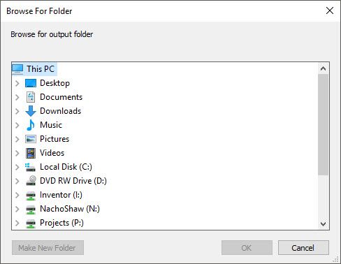

Giving a Browse Folder Dialog like this:
To use, you need something like this:
Me.MyTextbox.Value = ShowFolderDialog
