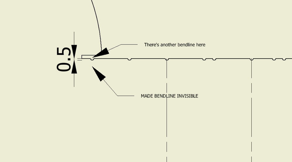

I'm looking for a way to get the length of bendlines in a drawing.
Reason it because I have small bendlines that I want to ignore. All other bendlines need a bendnote.
Now.... I can't get the length of the bendlines no matter what I try and I'm at a loss. HALP!
