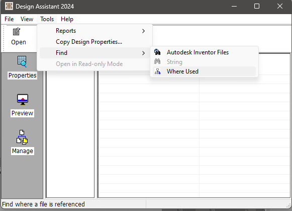

The Document.FindWhereUsed method works about the same way.  It will only search within the other documents that are currently loaded in the active session of Inventor, and won't search your entire file system.  There is a standalone tool that gets installed with Inventor named "Design Assistant", which has some functionality for 'Where Used', and that will actually search throughout your entire project space, of file system, if you want it to, but if that area contains tons of files (like mind), then may take a really long time to do.
