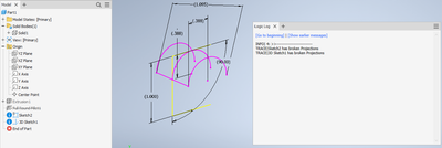

@emanuel.c,
I would just use the HealthStatus property that @WCrihfield mentioned.  Both Planar and 3D sketches have the property and return "kDriverLostHealth" when there are sick projections
Dim pDoc As PartDocument = TryCast(ThisApplication.ActiveDocument, PartDocument)
If pDoc Is Nothing Then Logger.Debug("Not Run In Part Document") : Exit Sub
For Each sk As PlanarSketch In pDoc.ComponentDefinition.Sketches
	'Logger.Trace(CType(sk.HealthStatus, HealthStatusEnum).ToString)
	If sk.HealthStatus = HealthStatusEnum.kDriverLostHealth Then Logger.Trace(sk.Name & " has broken Projections")
Next
For Each sk3d As Sketch3D In pDoc.ComponentDefinition.Sketches3D
	'Logger.Trace(CType(sk3d.HealthStatus, HealthStatusEnum).ToString)
	If sk3d.HealthStatus = HealthStatusEnum.kDriverLostHealth Then Logger.Trace(sk3d.Name & " has broken Projections")
Next
I'm not sure what will be returned if there are more issues than just broken projections, so i left the Enumerator report line in.  remove the ' to have it run if you have sketches that should be caught but are not returning "kDriverLostHealth".

J-Camper
@emanuel.c,
I see your issue better now.  There was no 3D sketch in the attached part and when i made one it still knew it was broken, so i don't fully know the workflow for getting undiagnosed sick projections.  I did apply your same logic from planar sketches to 3D sketches and it appears to work on the 3D sketch I added:
    ' Check 3D Sketches
    For Each o3DSketch As Sketch3D In oPDef.Sketches3D
        Dim brokenProjectionFound As Boolean = False
		For Each oSE3d As SketchEntity3D In o3DSketch.SketchEntities3D
			Try
                If oSE3d.Reference Then
                    If oSE3d.ReferencedEntity Is Nothing Then
                        brokenProjectionFound = True ' Found a broken projection
                    End If
                End If
            Catch
            End Try
		Next
        If brokenProjectionFound Then
            brokenSketches.Add(o3DSketch.Name & " (3D)") ' Add 3D sketch name to the list with type
        End If
    Next
Full modified rule attached as txt file to save space.

emanuel.c
Wow that's beautiful! Works very well!
Ya, even where I tested it on a 3D sketch, those sketches were actually called out as "sick" and Inventor does kind of call them out - at least when an update is being made... Still the code is useful to be able to run from a top level assembly over all referenced parts.
I don't know why Autodesk thinks it's OK to allow the flow to move on and not notify the user in such cases. But this will be helpful in catching those broken things.
Thank you!
