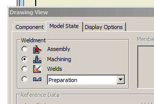

i'd like to drive a parameter depending on the level of detail being shown.
How can find which LOD is active within ilogic?
I'll use this for driving a weldment : when the weld is on the bead parameter = 6 when the weld is off the bead parameter = 0.1

you can get the current Level of detail name by "AssemblyDocument.LevelofDetailName"
suppose you have a LOD named "Weld" in your weldment, try the iLogic code as below
doc = ThisDoc.Document
If doc.LevelofDetailName = "Weld" Then
     ' BeadSize is the parameter name for bead
      BeadSize = 0.1
Else
      BeadSize = 0.2
End If

Thanks, it works but I'm stupid - I really should of used:
Slightly on the same issue - Trying to trigger your code to refresh automatically - i.e the View Changes when a LOD is selected - currently need to run rule then press update.
I have other code & the refresh & update always needs clicking & updating manually.
Secondly trying to have a drawing view swap between LOD & update is just wrong thinking on my part - the drawing can only reference the model & LOD only loads & unloads - two models will not exist showing two different weld sizes.
