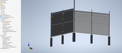

I have a ComponentPattern in my assembly.  It is the barcable that ends 747 as shown in the image.
I am trying to figure out if the selected component is part of a pattern.
My code looks like this.
 I just can't seem to figure out how to get to Element 1 or Component Pattern from the selected Component.

 I think I figured it out.

Once you know the occurrence is a "OccurrencePatternElement", you can use the ".PatternElement" method to get the occurrence as a OccurrencePatternElement Object which has methods.
You need to use the "Parent" method to get into the OccurrencePattern Object.

I just posted notes about how to route from "ComponentOccurrence" Object, which is a Pattern Element, to the source "ComponentPattern" Object.  Which has methods you could use for count.
There is also a method under the "ComponentPatternElement" Object call "Occurrences" which might limit the count to Occurrences using the same document.  If you have multiple Occurrences in the same Component Pattern, This might be more useful:
occ1 As ComponentOccurrence
occ1 .PatternElement.Occurrences
