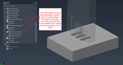

ROBOMACH_PL_1
@JhoelForshav ,
I would like to modify your rule but I have a problem with that.
My point is exactly that:
1. I would like to be able to copy (pick) any number of surfaces with holes on one base surface.
2. I would like the result of this operation to be one sketch (now each projected hole is a new sketch and a new cut) with all the slots as it is now.
It seems to me that for a skilled programmer it is a small matter, but unfortunately I am a complete amateur. If point 1 would be a problem, I would be completely satisfied with solving the problem from point 2.
Would you be able to help me ??
Regards,
ralfmja
Message 13 of 15

However, I am intrigued by point 1, i.e. how to add the possibility to choose several planes ??
I think I know what to do but I don't know how 😄
I would select several planes using the code:
Dim oSurfaces As ObjectCollection = ThisApplication.TransientObjects.CreateObjectCollection
While True
   oFace = ThisApplication.CommandManager.Pick(SelectionFilterEnum.kPartFaceFilter, "WSKAŻ PŁASZCZYZNE Z OTWORAMI")
	' jesli nic nie wybrane to
	If IsNothing(oFace) Then GoTo wybor2 Else
	oSurfaces.Add(oFace)
End While
but I have no idea how to "stitch" these planes together so that the rest of the rule would be based on this stitching ??
Would anyone be able to help on this topic ??
Thanks in advance,
Best regard,
ralfmja

ROBOMACH_PL_1
Hi @florian_wenzel ,
thanks for you answer.
Yes - all planes with holes are flat and parallel to the plane on which it is projecting.
It is intended to be a "streamlined" tool for the adaptive projection of holes from different parts onto the one in which these holes are to be formed.
Inventor's standard approach to adaptability in large assemblies causes numerous problems with adaptability. For do this I use the "copy object" tool and then project that object onto the sketches and make the appropriate holes. The rule described in this topic allows you to significantly reduce the time required for these operations. However, it would be ideal for me if I could select and project all surfaces "at once".
But I never know how many planes I want to project (sometimes one, sometimes two, sometimes maybe 10 etc.).
Selecting planes seems to be done, but needs help in "joining" them and using them to project onto a selected plane.
I agree with you that it should be easier than with "rounded" surfaces, but I don't know how to do it anyway. 🙂
Thanks in advance,
Regards,
ralfmja
