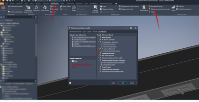

I have a piece of code where the saved part works normally after I run it, but the part that runs external rules does not work. I don't know why. Can someone help me.The attachment is my test file.🤔

Did you do that?
865966724
Yes, thank you very much. This was successful, but I still have a question. Can I rely solely on code to complete this task? Perhaps my understanding is questionable.
