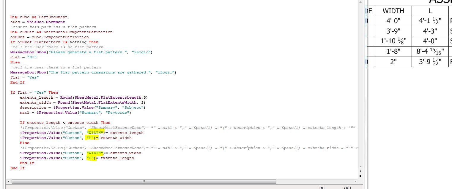

Modified the first code you posted (slightly) to create two separate "L" and "WIDTH" custom iproperties, then attached it to a form for easy access across multiple parts. It works like a charm! Thank you.
