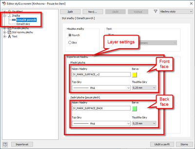

Michael.Navara
I don't know it is solution, but may be a workaround.
Layer settings for MarkSurface layer is available in StylesEditor. I hope (not tested) it is modifiable using standard API for styles.
Later on your code works without settings in sOut string and respects this style settings.

JelteDeJong
I did not know it was there as a style and it does what I need (for now). But still, I'm surprised that I'm not able to change the layer by code.
With your information, I did have an extra look at the API of the "MarkFeature". But I'm also unable to change the mark style for a specific feature. I can't even find the style name used by a specific mark feature.
