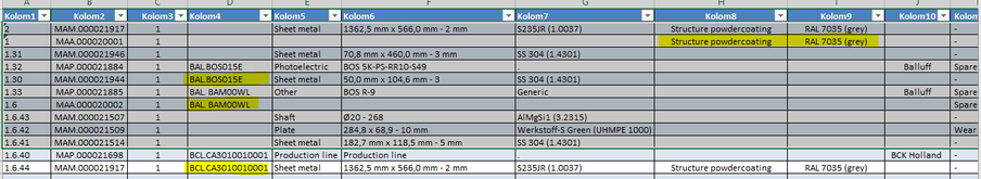

The rule works but there are two problem I couldn't fix.
Problem 1:
 Call oBOMView.Sort("Item", True)
This part should sort the BOM list according to Item number.
The output isn't sorted.
Any ideas why this isn't working?
Problem 2:
The property oPartArticleNo doesn't reset so it pops up in mutple lines.
I have tried to do a set after the export  Set oPartArticleNo = "" this isn't working.
How should it be?

Public Sub BOM_Export()
    ' Set a reference to the assembly document.
    ' This assumes an assembly document is active.
    Dim oDoc As AssemblyDocument
    Set oDoc = ThisApplication.ActiveDocument
    Dim oTemplate As String: oTemplate = "I:\Engineering\Formulieren en lijsten\Spare & wear parts lijst\Spare_wear_parts_Engels_Nieuw artikelnummersysteem.xltx"
    ' Set a reference to the BOM
    Dim oBOM As BOM
    Set oBOM = oDoc.ComponentDefinition.BOM
    ' Set whether first level only or all levels.
    oBOM.StructuredViewFirstLevelOnly = False
    ' Make sure that the structured view is enabled.
    oBOM.StructuredViewEnabled = True
    'Set a reference to the "Structured" BOMView
    Dim oBOMView As BOMView
    Set oBOMView = ThisApplication.ActiveDocument.ComponentDefinition.BOM.BOMViews.Item("Structured")
   ' Dim oBOMView As BOMView
   Set oBOMView = oBOM.BOMViews.Item("Structured")
    Dim oPartNumProperty As String
    oPartNumProperty = oDoc.ComponentDefinition.Document.PropertySets( _
        "Design Tracking Properties")("Part Number").Value
    Dim oPartRevNum As String
    oPartRevNum = oDoc.ComponentDefinition.Document.PropertySets( _
        "Inventor Summary Information")("Revision Number").Value
    Dim oPartTitle As String
    oPartTitle = oDoc.ComponentDefinition.Document.PropertySets( _
        "Inventor Summary Information")("Title").Value
    Call oBOMView.Sort2("Item", SortByString)
    ' set excel app and add worksheet
    Dim xlApp As Object
    Dim xlwb As Object
    Dim xlws As Object
    Set xlApp = CreateObject("Excel.Application")
    Set xlwb = xlApp.Workbooks.Open(oTemplate)
    'Set xlwb = xlApp.workbooks.Add
    Set xlws = xlwb.Worksheets(1)
    xlApp.Visible = True
    ' write more stuff
    ' xlws.Cells(1, 2) = oPartTitle
    ' xlws.Cells(1, 3) = oPartNumProperty
    ' xlws.Cells(1, 4) = "Rev: " & oPartRevNum
    xlws.Name = "Export list " & oPartNumProperty
    'Initialize the tab for ItemNumber
    Dim ItemTab As Long
    ItemTab = -3
    Dim oStartRow As Integer: oStartRow = 2
    Call QueryBOMRowProperties(oBOMView.BOMRows, ItemTab, xlApp, xlwb, xlws, oStartRow)
End Sub

Unfortunately the sorting isn't working.
 The BOM list looks like this:
The Item column is sorted as you can see.
This is exactly the way i want it be exported to excel.
My code produces the next list
any suggestion why the sorting doesn't do it the same?
The problem of resetting is as following.
In column 4, 8 and 9 you can see custom properties.
When the code want's to fill the next row in excel it should reset the memory.
Some parts don't have these custom values and the code fills in the same value as the previous row.
I have made these cells yellow so you can see what i meen.

That have done the trick with the resetting .
It resets now the properties to nothing.
The only challenge is the sorting 👌
Have a nice day!
J.Classens
@WCrihfield
I have tried some tricks but the sorting still doesn't work.
It seems to not sort at all. should do the sorting like in the BOM list.
It provides the next excel sheet.

Is there something in the code that prevents the list to sort before exporting?
