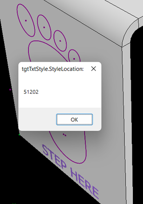

Maxim-CADman77
I've initially wrote that style is Local.
Here is the direct proof with line
MsgBox(tgtTxtStyle.StyleLocation, ,"tgtTxtStyle.StyleLocation:")
