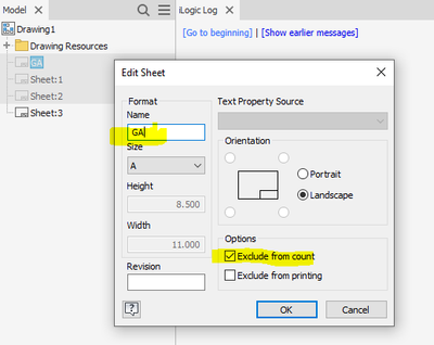

Hi All,
I've recently been trying to get drawing sheet numbering to start from 0 instead of 1 due to the top level being a GA (0) and all other subsequent levels being piece parts (1+). Is there a way to do this automatically within the IDW drawings?
TIA

Curtis_Waguespack
Hi @ben_saundersHDKKB
I think the closet you can get is to edit the GA sheet and set it to "Exclude from count"
This will result in GA, with no number, and the next Sheet starting at :1, as shown below.
I hope this helps.

ben_saundersHDKKB
Hi @Curtis_Waguespack,
The is the solution I had been using for the time being so it looks like I'll carry on with it. Thank you!
