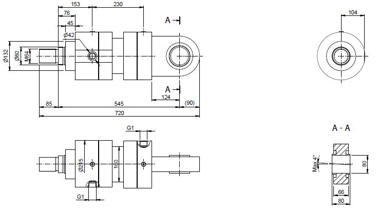

Now is the hardest thing (with me) that is to make dimension for the drawing.
How I can select the edge as a person do? What I need to write for the program in VBA to have a drawing like this:pic2.JPG
I find in the Programing Help > Drawnig Dimensions, but I just see something very complex.
DrawingCurveSegment, DrawingCurve, GeometryIntent,Vector2d, etc.
I found something in Mr Brain blog (modthemachine), but I don't understand too
Is it impossible mission for me to make upper drawing by VBA?? Please help!!!!
Is there any materials that simple can be worth for me in this case???
Many thanks in advance!

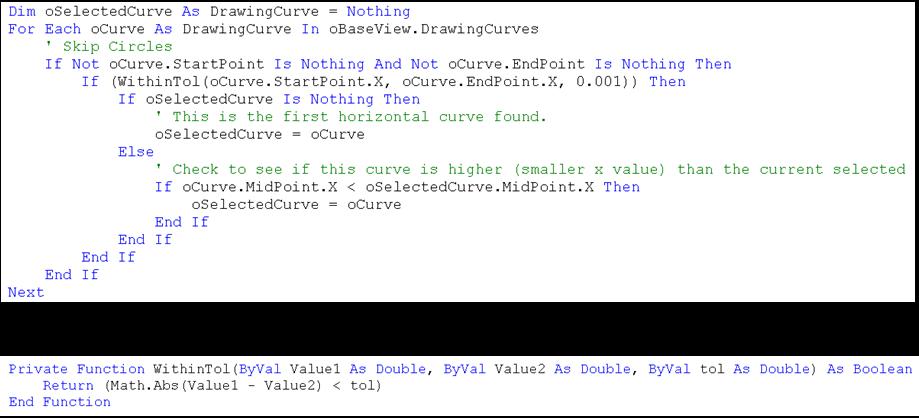

        ' find the left horizontal line
        For Each oCurve0 In oBaseView.DrawingCurves
            If Not oCurve0.StartPoint Is Nothing And Not oCurve0.EndPoint Is Nothing Then
                If (WithinTol(oCurve0.StartPoint.x, oCurve0.EndPoint.x, 0.001) = False) Then
                    If oSelectCurve0 Is Nothing Then
                        Set oSelectCurve0 = oCurve0
                    Else
                        If oCurve0.MidPoint.x < oSelectCurve0.MidPoint.x Then
                        End If
                    End If
                End If
            End If
        Next

Something which is very complex is still waiting for me, that is I want to make the Centerlines for some views, using Centerline Bisector cmd, centerline cmd, and center mark. How to do this??????
After that, how we can choose the centerline and drawing line, I means that it seem to be the DrawingCurve is only use for Curve of Object in view, not the Annotated Line?????????
Message 9 of 21

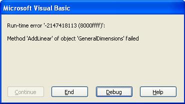

I am trying to dimension my drawing as the aforementioned picture, but there are big problem here.
 I don't understand why sometimes it can get the curve and sometime it cannot?
Everything is just like a chaos here, and I cannot control this.

Private Function WithinTol(Value1 As Double, Value2 As Double, Tol As Double) As Boolean
    Math.Abs (Value1 - Value2) < Tol
End Function
Why I cannot get the vertical linear curve have length 1.28 cm in my drawing, I go wrong from the first curve???????????
I feel my proficiency improved a lot with the current project, more than 1700 lines of code now.
But when I do dimensions for drawing, it's is just like impossible thing??????
Someone who already make dimension for a difficult drawing, please answer this question: "Normal or Hard or Very Hard or Impossible??????"

I got a problem in dimension that is I cannot use GeneralDimensions.AddLinear to dimension between a centerline and a line curve
'oCLine100 is the center line, oLCurve100 is the line curve. Two lines is parallel. oDimPos is the point 2d
Dim oGI100, oGI101 As GeometryIntent
Set oGI100 = oSheet.CreateGeometryIntent(oLCurve100)
Set oGI101 = oSheet.CreateGeometryIntent(oCLine100)
Dim oLDim100 As LinearGeneralDimension
Set oLDim100 = oSheet.DrawingDimensions.GeneralDimensions.AddLinear(oDimPos100, oGI100, oGI101, kDiametricDimensionType)
Please help me to figure out what goes wrong in the code????
This GeneralDimensions.AddLinear() is really terrible. It make my Inventor crash down more than 15 time per day........... although I use "On Error Resume Next" before the code line or not.
Message 13 of 21
