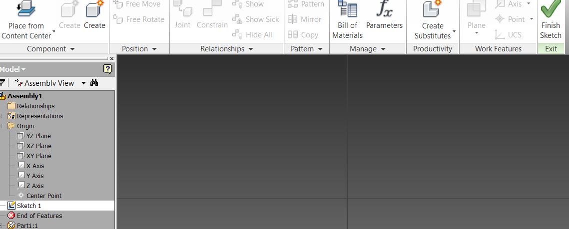

How to disable the button when in the sketch environment (or any other)?
I was looking through the rack face sample and thought I had it but alas, no. In the attachment you can see my button is still enabled when an assembly sketch is active. I intend to replace the Create Component button.  FYI i'm a novice when it comes to .NET and addins so spell it out for me.
Alternatively is there a better sample I can look at?
I have already added the handler to the activate event.  My button definition is a public variable in another module, could this be the problem?

Would you be able to share the code (if non confidential) where you are creating the button definition BtnDefCreateInPlace? Since ideally, if you call the BtnDefCreateInPlace.Enabled = True / False you should be able to enable and disable the button in that environment.

The condition in the loop is set as
 If Not envInternalName = "AMxAssemblyEnvironment" Then
This will actually enable the create button when not in AMxAssemblyEnvironment , that is in the sketch environment.
To disable the button in any environment other than AMxAssemblyEnvironment   you can change the if condition to
If envInternalName = "AMxAssemblyEnvironment" Then  'remove Not
Another way to achieve this would be to disable the BtnDefCreateInPlace when in sketch mode.
If Environment.InternalName = "AMxAssemblySketchEnvironment" Then ' check if sketch environment
' set the button as disabled....
Please let me know if this solves the problem.

I eventually found my mistake.  In the activate sub where I was adding the handler I had a . instead of an _
ie me.m_UIEvents.OnEnvironmentChange instead of me.m_UIEvents_OnEnvironmentChange
I realised during debugging it wasn't calling the sub at all.
