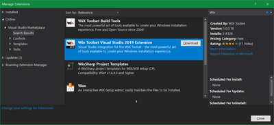

Don't you know whether "Wix Toolset Visual Studio 2019 Extension" would be enough or should I also install "Wix Toolset Build Tools"?
Please vote for Inventor-Idea Text Search within Option Names
Message 4 of 20
Michael.Navara
You need to install WiX Toolset build tools and also VS Extension as you mention above.

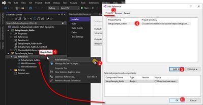

Could you, please, explain how you've put C#-entry under References of SetupSample_Setup project?
Message 11 of 20
Michael.Navara
Message 12 of 20
Maxim-CADman77
Thank you.

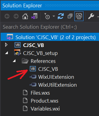

I wonder is it ok not to get correct (C#) entry icon (like on your screenshot)?
PS:
I'm asking this because I fail to reference files of my Add-In project in my Setup project via project name variable. I'm using VB and payed attention the two icons differ:
thus decided I'm missing something.

Maxim-CADman77
Yes - I was doing wrong (and generic icon was the marker of it).
The fault was adding DLL instead of the Project (using wrong Tab in Add Reference dialog).
Now icon is correct:
and preprocessor variable works as expected.
Sorry for stupidity.

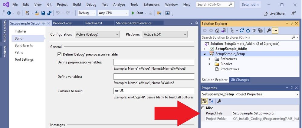

Could you, please, share the screenshot showing content of properties panel for the setup project of the solution you've provided (select the setup project and press F4)?
I'm asking for this because I do suffer several unexpected issues* and I believe the problem might be in my VS config.
Property set that my VS shows I believe looks incomplete:
If I'm not mistaken the ARPPRODUCTICON property should be there, right?
One of issues mentioned - when I try to customize icon for my add-in's entry in Program and Features I does change but just to some another standard/generic icon 😞
