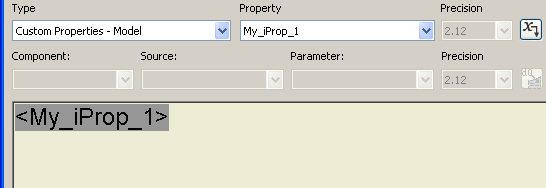

I didn't spend too much time on this but I did come up with a bit of a hack solution, that might work for you (but I sort of doubt it as it has a big flaw). But I'm going to post what I have and hope that someone else might jump in and provide the missing part.
The hack comes in two parts, first is just a rule that will get the custom iProperty ID and formatting from a view. So you'll want to edit your drawing view and add the custom iProperty to it as such:
Then you can use this rule to get the ID and format for the custom iProperty:

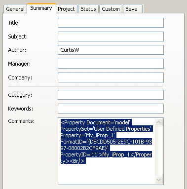

Then you can look in the drawings comments property and find the string to use in the next rule for that iProperty:
So copy that string and enter it in this code, replacing the custom iProperty I have entered:

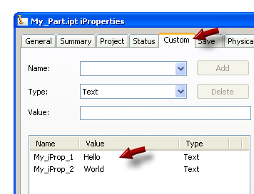

Message 7 of 19
Curtis_Waguespack
Hi grinderz,
Okay nevermind the previous post, I was able to get this sorted out. Here's the code and a couple of sample files.
I hope this helps.
