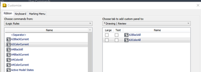

I have some iLogic rules and forms. Now I am adding them to "User Commonds" as below shown.
How can I change the default photos for the rules? I want to use my own photos to identify the rules.

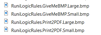

You need to add bitmaps to the folder that contains your rules.
You'll need and 32x32 for the large icon, and 16x16 for the small one.
The naming of the bitmaps is important though.
You need to include the macro that is running it, the rule name and it's size.
In your case it would be something like iLogicRules.A3BlackAll.Large
I've attached a screen of my old bitmap names for example.
