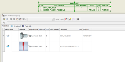

I am trying to change the i properties in the content center parts to line up with our company's standard, naming and property fields. I'm working on the hex bolt inch and want to add Vendor, Mounting ext... I can't get it to display in my BOM.
I've made the part editable.
-add column
this is what I fill in (and where I think the disconnect is)
Refresh
It doesn't show in my custom properties or in my BOM.
Please what am I missing here?

Assuming your seeing this iproperty in the part, can you confirm? Then you need to add the column in the BOM editor and also separately to the part list column manually or in the styles editor.

It is linked to a custom Iproperty in my BOM. I did just add a "custom Iproperty column" for vendor and it showed up there but still not showing up in my BOM.
CcampbellYCLST
I found this interesting as well. the bridge is showing up on the bom table but not the bom editor and vice versa for the bolt.
A.Acheson
Could this be an issue with the built in iproperty vendor and your custom iproperty also called vendor? Any reason for creating the custom iproperty?
If you don't have any issues with this then your CC part could be out of date. Try a refresh. This will force the CC to read from the library and not just from the file placed in the CC files folder.
