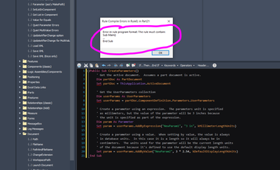

@A.Acheson Thanks for the links, looking through now, I tried this one, but the code returned an error that I am not familiar with how to fix? (this is the 3rd link you provided)
Message 4 of 18
mat_hijs
In iLogic there needs to be one main sub that will run when running the rule, when not explicitly stating subs the sub called "Main" is implied. If you want to use multiple subs you'll have to explicitly state one as Sub Main. So to solve this error you have two options, either replace "Public Sub CreateParameters()" with "Sub Main()" or remove "Public Sub CreateParameters()" and "End Sub".
You can read more about this here: https://help.autodesk.com/view/INVNTOR/2024/ENU/?guid=GUID-32B66838-22E4-4A0A-B5BB-862350C76B36

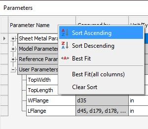

Also, this will not give you the ability to reorder, and I'm not aware of a way to be able to do that easily because parameters will be referenced in sketches, features, other parameters, ...
Message 12 of 18
Frederick_Law
How about just sort the list?
Message 13 of 18

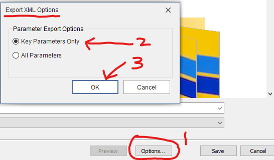

Sorry if I was not very clear.  I have never created an XML file from scratch like you are talking about for the purpose of importing Parameters into an Inventor document.  The XML file gets created automatically for me when I export the parameters from an existing Inventor document.  Within the Parameters dialog of a model file, you will see something like the following in the lower left corner of that dialog.
When I am doing this process manually, I start from an existing model document that already contains all the parameters in it that I want to reuse in another model document, then I click on the 'Export to XML' button (circled in red) above, or I click on the similar button out on the main ribbon by the same name, as seen in the image below.
When you click that button, a dialog opens wanting you to specify where to create / save the new XML file, and what to name it.  While that dialog is open, click on the Options button, then choose the 'Key Parameters Only' option (if that is the one you want), then proceed to create the new XML file.
The lines of code I showed you in Message 13 were for use within an iLogic rule only, and are for the same functionality as these manual methods shown above.  When you export an XML file this way, you can open that XML file that it created to review how it is formatted, but I have never had to mess with the 'contents' of one of these XML files before.
Then, when I have some other model document open (the one I want to put those parameters into), I either use the button on the ribbon, or open the Parameters dialog, click on that 'Import from XML' button, choose the XML file that I exported from the other model document, and click OK.  Now all those parameters are in my current model document.  I would not want to completely, manually type out the whole contents of the XML file in a text editor for a lot of parameters.
I have attached a very simple example XML file that was created this way from a simple test part.
