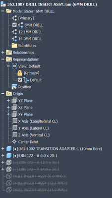

I'm trying to replicate an annoying feature of some of our client's BoM's on multi-assembly drawings. They use a REALLY annoying format for multi assembly BoM (see image).
For the last two years we've used all sorts of fudges with a mix of sketch symbols and manual BoM overrides but it's horrible so I'm looking to make something better.
The solution I've come up with (that works 100% if I do it manually) is to:
  1. [Assy] Create a model state called [Primary] that contains a virtual component for each configuration and has everything else supressed.
  2. [Assy] Set the relevant iProps in each virtual component to match the model state iProps (part number, stock number (what we use for part number), description etc.
  3. [Dng] Drop in base views for each model state and then insert a parts list for each, using a style with a header for the [Primary] and a style with no header (the red boxes) for the sub parts.
This is way better on the drawing, because I only have to hide a couple of rows and update a couple of columns with static values, but it’s a faff so I’m trying to automate.
I’m “low to moderate” with iLogic but I’ve gathered up a load of code snippets and put something together that is working ok.
Only problem is that when I try to add the mass properties to the virtual components I get really strange behaviour – it’s row 98 in the attached code.
For some reason the masses don't update to be correct, instead they are like 6 x the value they should be. I'm wondering if I need to use a different line to get the mass just for the model state or something?
Note, the code's a work in progress and I'm enjoying working on it and learning - just spending an unreasonable amount of time on this mass issue so wanted to ask for some help 😞

OK! I thought I'd post an update in case anyone is discovering this in the future and wants to know the answer.
I've spent all weekend on it, running trials and.....
I think it is a bug in Inventor - I'm using 2025.2.1 - build 293.
Inventor isn't ignoring the mass of supressed parts when it makes the mass calculations - if the part is a virtual component.
To recreate the issue:
In the attached model files, there is a virtual component and a real component.
If you set the mass of the virtual component to zero and record the mass of the assembly it is 0.008kg.
Then manually set the mass of the virtual component (Unsuppress, iProps, Physical and type into the Mass box) to 0.1Kg.
Check the mass of the assembly - it is 0.108Kg as expected.
Then supress the virtual component.
Check the mass of the assembly - it is still 0.108Kg.
That's different behaviour to if the "real part" is suppressed, in which case it's mass is no longer included in the calculations.
Is this expected behaviour?

Can confirm this behavior in Inventor 2023.5.2, build 446.
I don't expect suppressed virtual components to be counted as part of the total mass.
Especially when Inventor tells me that suppressed components will not be part of the BOM when I (un)suppress them.
Not part of the BOM, not part of the mass, right?
