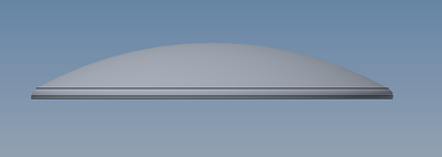

So I currently have nothing at the moment to copy the features. If I can't copy the features I have to make for the 4 diffrent holes multiply that by 10 each. That will take for ever if i need to do that. And i need to do that with 3 diffrent parts.
If you know a better way or easyer to cut a hole in a cone or a "bodem" (dutch, don't know the translation see below for picture of it) that would be awesome.
