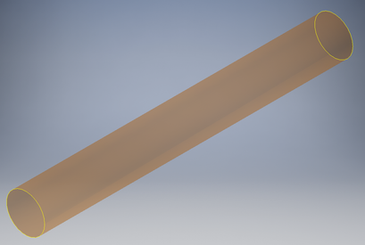

Hello everyone,
I'm trying to create a surface around parts that have holes or cuts on them, so I can only have the external shape. I created a code to get the part as surface, but I don't want the holes and cuts to create new surfaces that cut the main surface.
The parts:
What I want:
What I'm getting:
How can I achieve this?

JelteDeJong
depending on your inventor version, you could look at the shrinkwrap or simplified part command. I think one of that commands will do what you want. Depending on your needs you can choose to automate workflows with those commands.

dialunau
I tried the shrinkwrap method, it works perfect.
Now I just have an additional question: is there a way (after breaking the link) to place the whrinkwrap in the exact position of the original part in an assembly?
