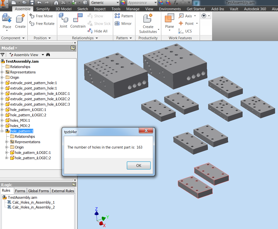

Hello!
Please tell me how to use the iLogic cod, count the number of holes in the assembly
Thank you
Tatiana

TatianaR
Hi Vladimir
Thank you very much for your help.
But I have another question, hope - the last Smiley Happy
How to count the number of holes in the assembly file?
Files for an example - I added
Whether this is possible in general, counting the holes different ways in a single file?

Vladimir.Ananyev
Hi Tatiana,
I've attached assembly  with iLogic rules that could help you to start.
The first rule Iterates through all leaf occurrences collection.
The second rule Iterates through all referenced documents collection.
The last should be more efficient if your assembly includes a lot of copies of parts with holes.
(I did not test this idea though).
Both Main methods call the same function GetHolesQty which returns the number of holes in the specified part component definition.
Please note that this function cannot work with nested feature patterns.
Approach 1.  Iterates through all leaf occurrences collection.
Sub Main()
    Dim oAsmDoc As AssemblyDocument = ThisDoc.Document
    Dim oAsmDef As AssemblyComponentDefinition = oAsmDoc.ComponentDefinition
    Dim N As Integer = 0    'holes counter
    For Each oOcc As ComponentOccurrence In oAsmDef.Occurrences.AllLeafOccurrences
        If Not oOcc.Suppressed Then
            If oOcc.DefinitionDocumentType = kPartDocumentObject Then
                Dim oDef As PartComponentDefinition = oOcc.Definition
                N += GetHolesQty(oDef)
            End If
        End If
    Next
    Beep
    MsgBox ("The number of holes in the current part is:  " & N)
End Sub
Approach 2.  Iterates through all referenced documents collection.
Sub Main()
    Dim oOccs As ComponentOccurrences = oAsmDef.Occurrences
    For Each oDoc As Inventor.Document In oAsmDoc.AllReferencedDocuments
        If TypeOf oDoc Is PartDocument Then
            Dim m As Integer = GetHolesQty(oDoc.ComponentDefinition)
            N = N + m * oOccs.AllReferencedOccurrences(oDoc).Count
        End If
    Next
    Beep
End Sub

TatianaR
Dear Vladimir
Thank you for your help
I really appreciate it
In the assembly file I want not only the number of holes bur also the diameter of the holes.
for example:
12 holes - diameter 5 mm
5 hole - diameter 7 mm
Which functions is necessary for this purpose?
Best regards
Tatiana
