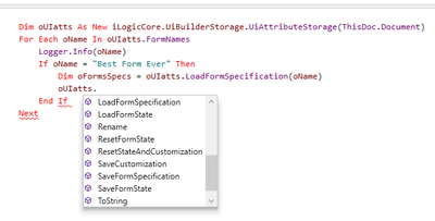

@JhoelForshav this is a pretty cool implementation to copy rules from 1 file to another, but I was wondering if it was possible to take it one step further and get a form from a source doc and copy that to your destination?
I added the below but once you get to the Automation there's nothing that references a form
Alternatively is it possible to use iLogic to create a form?  Or have a global form that can be accessed and copied into a destination document?
Sub CopyForm(CopyFrom As Document, CopyTo As Document)
	For Each oForm As iLogicForm In iLogicVb.Automation. 'Nothing exists beyond this point
Message 11 of 23

Hi @e_frissell.  There is currently not any easy way to do that by code.  It is certainly doable manually though.  When you create an internal iLogic form (saved within the document), a form specification is created, and the data for that form specification seems to be stored within the document attributes.  A new AttributeSet, and a new Attribute are added to the document, and the data for that form specification seems to be stored to the Value of the Attribute as a Byte Array.  There is a pretty complicated way of digging into some of the other iLogic resource references that are not normally included in regular rules, and a way to access these form specifications, but I haven't gotten to the point of being able to copy them from one document to another yet.  Were close though.  We can delete the forms you see in your Forms tab by deleting the AttributeSet / Attribute that are attached to the document, and whose name starts with specific text.  I am not sure if that totally deletes them, or just causes them to no longer be visible, and may be messing something up behind the scenes.  We just got the ability to close an open iLogic Form this year, so something like this may be coming soon.

Shame.  Saw an old post of yours that mentioned being unable to copy forms, but saw that you could right click and copy a form and that got me wondering if there'd been updates on this front

Hi @e_frissell ,
I did just a quick test and this adaption from the above examples seemed to work.
I hope this helps.
Curtis

It might be possible to simulate a series of mouse clicks that way in Inventor, but I have not personally created any automation solutions that way.  I have used the InteractionEvents and MouseEvents to capture mouse pointer position when the mouse is clicked on several occasions, but not the other way around.  Plus using the InteractionEvents is not very convenient.  Plus, since the main iLogic tab can be moved around on the screen, and the whole DockableWindow area can be hidden, resized, scrolled, deactivated (other sub tab activated), getting the exact location of an internal iLogic Form's user interface area on the screen reliably would be pretty challenging.
Wesley Crihfield

Whoa, there's a lot to unpack with that and frankly I'm not sure where to start haha your iLogic knowledge never ceases to amaze.  If you don't mind I'd like to post up what I'm running and could use some help integrating that into my rule.  Location would be as called out in sub Main

Cool.  I was hoping it was going to be that simple, but I simply had not tried it yet.  I just created a simple rule of my own to test with, and got an odd result.  When I first ran the rule, the other document was created and visibly shown on my screen.  Then I clicked into its Forms tab, and it was not showing anything.  Then I want back to the original document and looked at the sample Form there, and that was still there, as expected.  Then I went back to the new document and the form was now showing in its Forms tab.  This too must need a 'blink' type helper (toggle visibility of the iLogic DockableWindow).  When I tried it again, if I stay within that new document, looking at the empty Forms tab, then click the 'x' to close the main iLogic tab, then click the '+' to show it again, the form then shows up.  Similar situation to the 'delete forms' scenario.

Curtis_Waguespack
@WCrihfield wrote:
If I create the other new document 'invisible', then switch to that document by clicking on the view tab at the bottom, the form is already there, so it's not really much of a problem.
This and what you mentioned previously was what I was seeing also.
What I'd really like to be able to do is copy a specific form by name. There is a SaveFormSpecification call that might do it, but I don't have time to dig into it at the moment.
AddReference "Autodesk.iLogic.Core.dll"
AddReference "Autodesk.iLogic.UiBuilderCore.dll"
Imports iLogicCore = Autodesk.iLogic.Core
	Dim oUIatts As New iLogicCore.UiBuilderStorage.UiAttributeStorage(ThisDoc.Document)
	For Each oName In oUIatts.FormNames
		Logger.Info(oName)
		If oName = "Best Form Ever" Then
			Dim oFormsSpecs = oUIatts.LoadFormSpecification(oName)
			'oUIatts.SaveFormSpecification()
		End If
	Next
Message 20 of 23
WCrihfield
Me too. 😁  I have already been able to dig into the individual controls within the forms, but its all still a bit more complicated than I had hoped for.  And haven't found the time to dig deeper yet.  Fairly optimistic about it though.  And every one of these steps along the way helps. 👍
Wesley Crihfield
(Not an Autodesk Employee)
