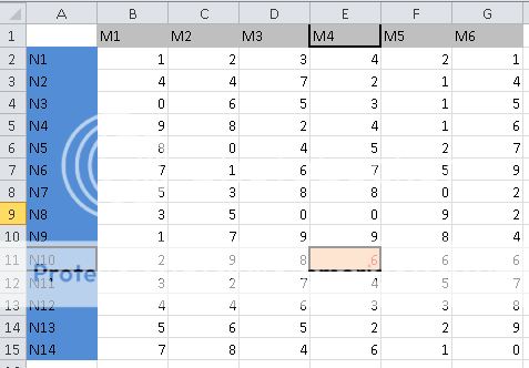

My college has create an macro in User Form that can change the Size and Shape of Part in model.
My job now is continue the process that create the drawing for this part (an kind of iPart but more complex).
My college use Access database in VBA to get the value for model, but I don't know how ( I just self study in Macro and have very little knowledge in programming).
So I type all tables into Excel file. Now every parameter in the table, about 10 sheet with hundreds cells.........
So I want to get the cell of Excel worksheet in some rules for example:
First, find the column for the value "M4" in the row 1; the result is Column E
then, find the row for the value "N10" in the column A; the result is Row 11
Then the cell value will be E11; value = 6
What I need to do? What material I need to study??????
I think maybe it can have a similiar structure as Inventor API:
Excel Application>>>>>>ExcelDocument>>>>>>>Sheet>>>>>>>CellValue(row,column)
However, I try a lot, but nothing happens.
Many thanks in advance!

I got the solution.........I write this in VBA
    'open Excel
    Dim oExcel As Excel.Application
    Set oExcel = New Excel.Application
    'Open the OLE excel file
    Dim oWorkbook As Excel.Workbook
    Set oWorkbook = oExcel.Workbooks.Open(ThisApplication.FileLocations.Workspace & "\" & "CONFIGURATION.xlsx")
    'Get the sheet oMount
    Dim oWorkSheet As WorkSheet
    Set oWorkSheet = oWorkbook.Sheets.Item(i)
    oExcel.Visible = False
    For x = 2 To 19 Step 1
        For y = 2 To 19 Step 1
            If (oWorkSheet.Cells(x, 1) = BORE) And (oWorkSheet.Cells(y, 2) = MM) Then
                If x = y Then
                    z = x
                End If
            End If
        Next
    Next
    Select Case oMount
        Case "MP5"
            A = oWorkSheet.Cells(z, 4)
            XO = oWorkSheet.Cells(z, 12)
            SC = oWorkSheet.Cells(z, 16)
            TotalL = A + XO + SC + UPSTROKE
            D = oWorkSheet.Cells(z, 6)
            TotalW = D
        Case "MF3"
            ZB = oWorkSheet.Cells(z, 12)
            TotalL = A + ZB + UPSTROKE
            UC = oWorkSheet.Cells(z, 16)
            TotalW = UC
        Case "MF4"
            ZP = oWorkSheet.Cells(z, 12)
            TotalL = A + ZP + UPSTROKE
            TotalW = UC
        Case "MT4"
            A = oWorkSheet.Cells(z, 5)
            ZB = oWorkSheet.Cells(z, 13)
            TM = oWorkSheet.Cells(z, 20)
            TL = oWorkSheet.Cells(z, 19)
            TotalW = TM + TL * 2
        Case "MS2"
            ZJ = oWorkSheet.Cells(z, 13)
            TotalL = A + ZJ + UPSTROKE
            FW = oWorkSheet.Cells(z, 17)
            TotalW = FW
    End Select
    oParams.Item("TotalL").Value = TotalL / 10
    oParams.Item("TotalW").Value = TotalW / 10
    MsgBox (TotalL)
    MsgBox (TotalW)
    oWorkbook.Close
    oExcel.DisplayAlerts = False
    oExcel.Quit
