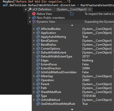

Here is the code I used to explore a contour flange built with default settings:
Dim f As ContourFlangeFeature = ThisApplication.CommandManager.Pick(SelectionFilterEnum.kPartFeatureFilter, "")
Dim fDef As ContourFlangeDefinition = f.Definition
break
' Report feature definition
Try
	MsgBox("Contour Flange Info: " & _
	vbCrLf & vbCrLf & _
	"DefaultWidthExtent: " & fDef.DefaultWidthExtent.Type.ToString & vbCrLf & _
	"DefaultWidthExtentType: " & fDef.DefaultWidthExtentType.GetTypeCode.ToString & vbCrLf & _
	"ExtentDirection: " & fDef.ExtentDirection.ToString & vbCrLf & _
 _	' "GetWidthExtent: " & fDef.GetWidthExtent.ToString & vbCrLf & _
 _	' "GetWidthExtentType: " & fDef.GetWidthExtentType.ToString & vbCrLf & _
 _	' "SetDistanceExtent: " & f.SetDistanceExtent.tostring & vbCrLf & _
	"MiterGap: " & fDef.MiterGap.ToString & vbCrLf & _
	"Operation: " & fDef.Operation.ToString & vbCrLf & _
 _	' "SetCenteredDefaultWidthExtent: " & fDef.SetCenteredDefaultWidthExtent & vbCrLf & _
 _	' "SetCenteredWidthExtent: " & fDef.SetCenteredWidthExtent & vbCrLf & _
 _	' "SetDistanceExtent: " & fDef.SetDistanceExtent & vbCrLf & _
 _	' "SetEdgeDefaultWidthExtent: " & fDef.SetEdgeDefaultWidthExtent & vbCrLf & _
 _	' "SetEdgeWidthExtent: " & fDef.SetEdgeWidthExtent & vbCrLf & _
 _	' "SetFromToDefaultWidthExtent: " & fDef.SetFromToDefaultWidthExtent & vbCrLf & _
 _	' "SetFromToWidthExtent: " & fDef.SetFromToWidthExtent & vbCrLf & _
 _	' "SetOffsetDefaultWidthExtent: " & fDef.SetOffsetDefaultWidthExtent & vbCrLf & _
	"", , _
	"DEBUG")
Catch ex As Exception
	MsgBox("Error: " & ex.Message)
End Try
BREAK
I was hoping to edit offset direction, extent direction, and extent distance.

Message 14 of 26
JBerns
Found access to the Extent Distance property:
f.Definition.DefaultWidthExtent.Distance.Expression = "2.0 in"
The Distance and Expression properties were not suggested by the IntelliSense tool when typing in the iLogic Editor. Used Visual Studio debugging to discover these. Maybe could have used Object Browser in the VBA Editor.
Now to change the extent direction. These all produce errors:
Call f.Definition.DefaultWidthExtent.Direction(PartFeatureExtentDirectionEnum.kPositiveExtentDirection)
Call f.Definition.DefaultWidthExtent.Direction(kPositiveExtentDirection)
f.Definition.DefaultWidthExtent.Direction = PartFeatureExtentDirectionEnum.kPositiveExtentDirection
f.Definition.DefaultWidthExtent.Direction = kPositiveExtentDirection
CAD Administrator
Using AutoCAD & Inventor 2025
Autodesk Certified Instructor
Autodesk Inventor 2020 Certified Professional
Autodesk AutoCAD 2017 Certified Professional

@WCrihfield,
I have been able to create a contour flange or cut feature, but there are definite limitations to editing existing features.
For example this code can create the contour flange feature, but can only change the extent direction.
''' CREATE '''
oCFDef.ExtentDirection = PartFeatureExtentDirectionEnum.kPositiveExtentDirection
Call oCFDef.SetDistanceExtent(5, PartFeatureExtentDirectionEnum.kPositiveExtentDirection)
' code to create contour flange normally here. Removed for brevity.
''' EDIT '''
oCF.Definition.ExtentDirection = PartFeatureExtentDirectionEnum.kNegativeExtentDirection  '<<== SUCCESS
call oCF.Definition.SetDistanceExtent(5, PartFeatureExtentDirectionEnum.kNegativeExtentDirection) '<<== ERROR - See below
System.NotImplementedException: 'Not implemented (Exception from HRESULT: 0x80004001 (E_NOTIMPL))'
When exploring the available properties in Visual Studio, it seems that all of the 'Set...' properties are missing.
I have attached my part that creates the sheet metal part contour flange and then attempts to edit the feature.

Message 20 of 26
J-Camper
@JBerns,
I changed Line 213 to set Direction through ".Definition.ExtentDirection"
I split the SetDistanceExtent @ Line 223 into two parts:
  1. Set distance through ".Definition.DefaultWidthExtent.Distance.Value" [.Expression can be used, but the code was just feeding in value so I followed that]
  2. Set Direction through ".Definition.ExtentDirection"
I got it functioning with minimal changes to produce no errors and attached the working code from my downloaded file. [I did change the template to one that I have]
