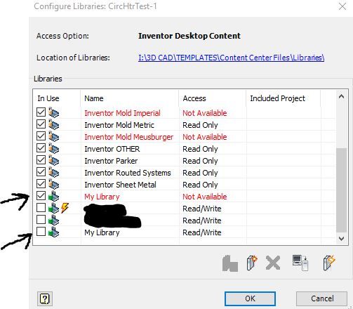

Is there a way in VB to programmatically check the Content Center libraries  "In-Use" checkbox in the "Configure Libraries" box for a Design Project as shown below?

Thank you for the response. When I run the code it creates a duplicate library node and checks it as shown below. I'm not very good with xml but I'm wondering if the function is creating a new node instead of finding the existing node or the Internal name that is used isn't matching the internal name of my library? Is there a function to read the internal name of my library to verify the internal name?

Internal names of libraries are varies from one system to another. Currently, Internal name of "My Library" in your system is different . So, it need to update(highlighted in red color) in below code.
