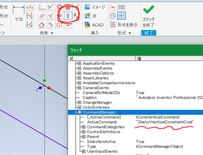

Please see two pictures below.
Built In CommandBuilt In CommandMy CommandMy Command
When I execute a built in command, the internal name of the command will be set to ActiveCommand.
But with executing my command that is created by C#, the name is not set.
I tried to get a name when OnExecute was just called.
public override void ControlEvents_OnExecute(NameValueMap options)
    System.Diagnostics.Debug.WriteLine("ActiveCommand : " + InventorApplication.CommandManager.ActiveCommand);
This caused...
ActiveCommand : AppSelectNorthwestArrowCmd
How can I set my command name to CommandManager.ActiveCommand?

jjstr8
I think what NachoUK is asking is what is the window in your original post with the green title bar?
Message 18 of 21
Thank you for the advice, jjstr8.
The window with the green title bar is the watch window of VBA.
(I should have run the English version, sorry > all)
